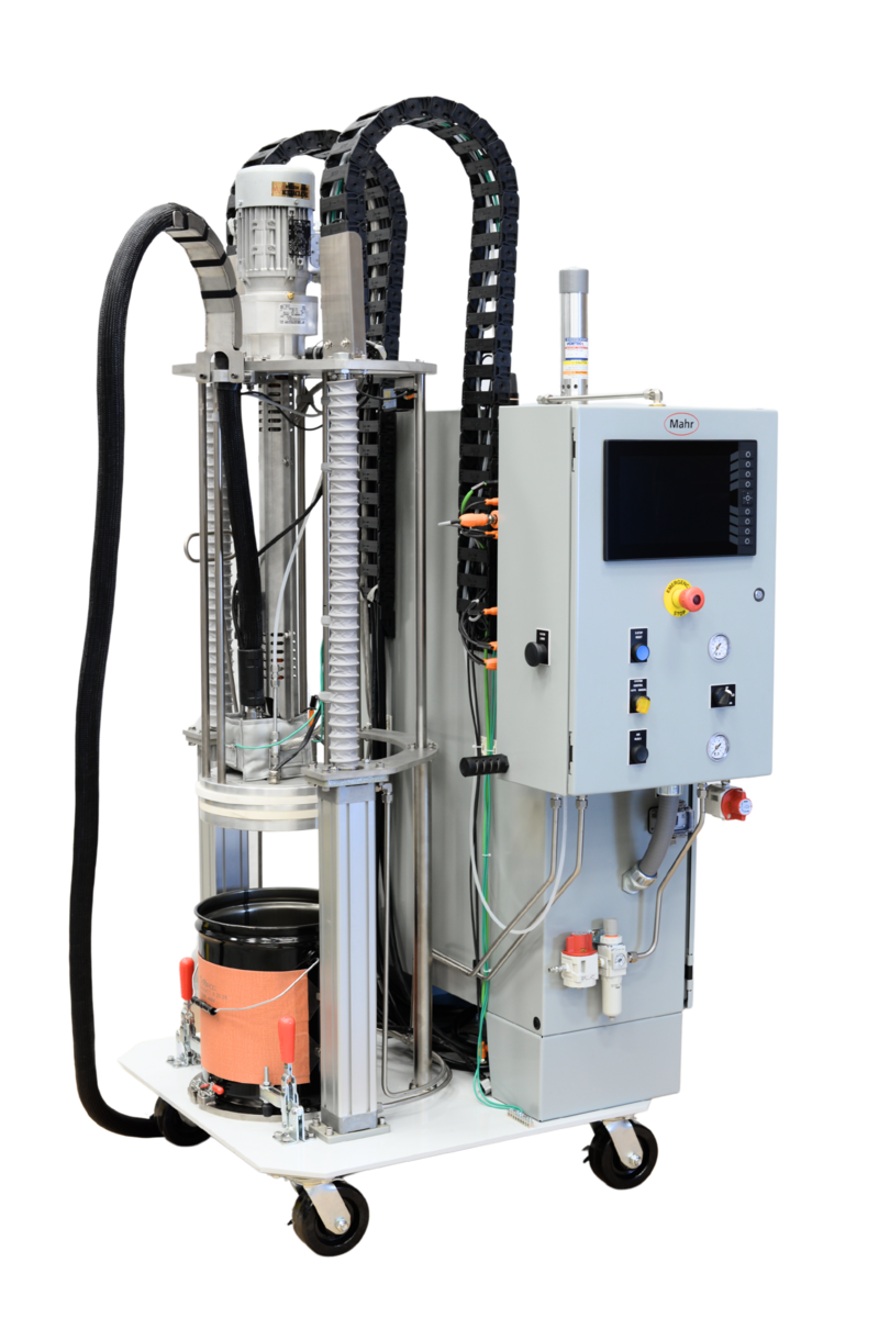

HV Platen System
Metering system for viscosities over 50 Pas that allows metering directly out of the container
HV High ViscosityPlaten System

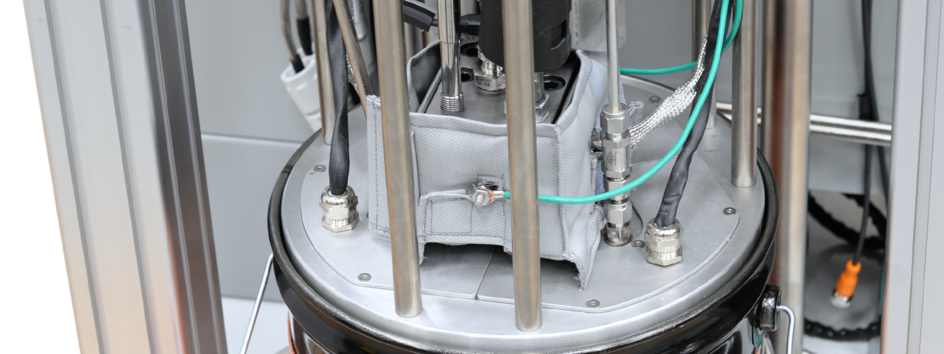

Mahr Drum Metering Pumps are designed for precise metering of products with varying viscosities, from thin to thick. Each system uses a gear metering pump, force-fed by a patented impeller design, ensuring metering accuracy of better than ±1%. The impeller helps minimize cavitation within the pump. The platen rides on the product surface, descending to the bottom of the barrel, and can be heated. A rubber gasket on the platen ensures complete cleaning of the container sides. Mahr Drum Pumps also prevent product contamination from air, gas, and moisture.
- viscosities up to 1,500,000 cP
- efficiently meters product to the drum's bottom
- metering accuracy better than ±1%
- available for 5 gal pail or 55 gal drum
With a Mahr drum pump, no feed pump is required, as it is mounted to a pressurized platen, eliminating the need for costly additional equipment. The drum metering pump provides high accuracy, with or without additional controls.
