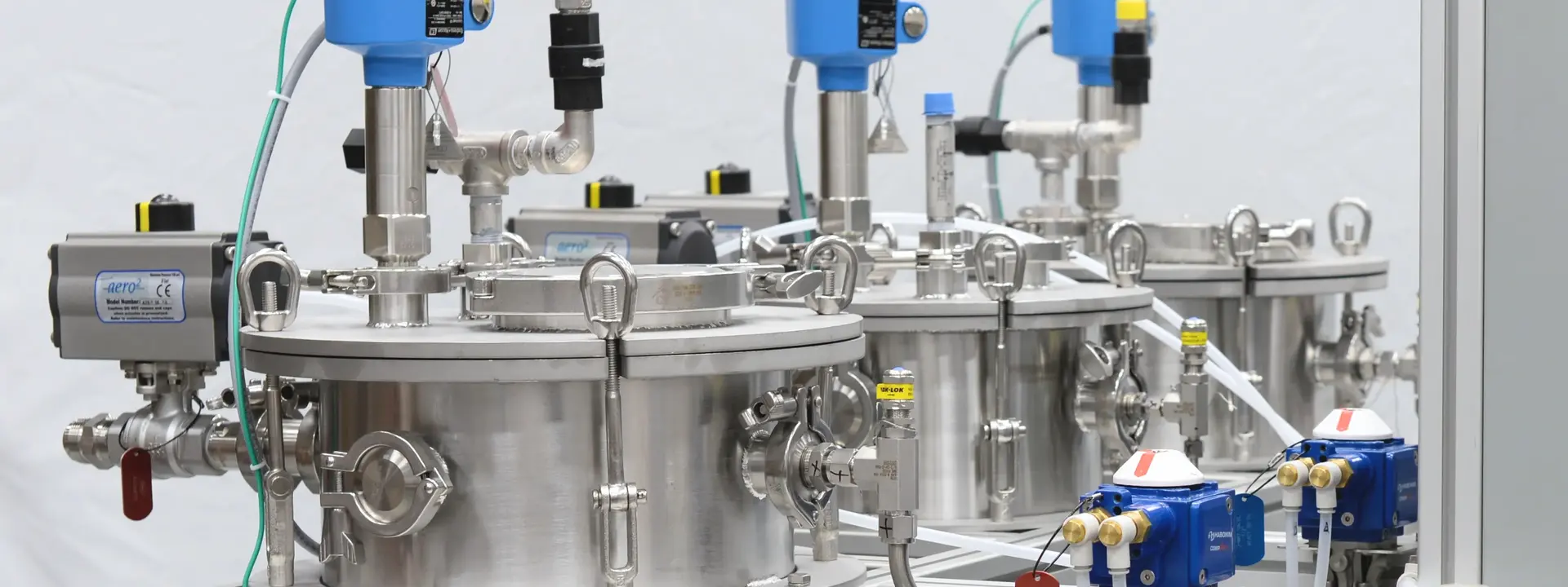

| Flow rate | Up to 10 gal/min |
| Mixing ratio | Infinitely variable |
| Material tank sizes | 5, 10, 20, 30, 40, 60 and 80 gal (larger sizes to suit) |
| Conveying element | Gear metering pump |
| Remote servicing | Remote service capability integrated |
| Tank filling | Manual |
| Control system | IFM with IO-Link, Siemens or Allen-Bradley |
| Operation via colour touch screen panel | 7, 10, 12 or 15" depending on system complexity |
| Heating | Unheated (optional heating) |
| Mixing Head | Suited to product and process |
- Gear flow meter / screw flow meter / coriolis flow meter
- Gear metering pump with magnetic coupling
- Alternative pump designs to suit unique applications
- Pressure monitoring on suction side
- Flushing medium container (5 or 10 gal)
- Shot counter
- Vacuum system
- Automatic refill control and equipment
- Heating for metering pump
- Recirculation - short or long
