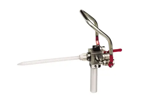

MarMax GSP 38 | manual
- 2 material ports for casting or spraying and 1flushing port
- ball taps with handle
- manual flushing valve
- operation via hand lever
- output: 0.5 up to 6 l/min
- material: aluminium or stainless steel

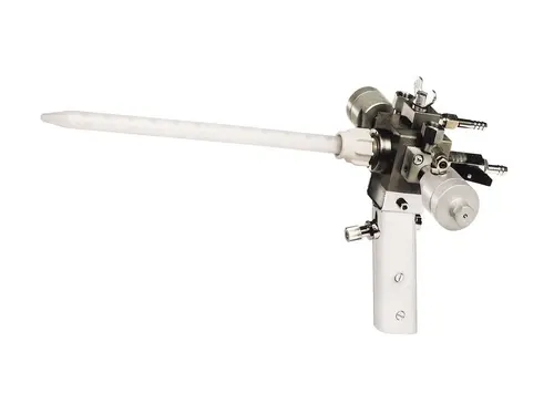

MarMax GSP 38 | automatic
- 2 material ports for casting or spraying and 1 flushing port
- pneumatically controlled material valves
- long recirculation available
- handle with electric push button
- manual or automatic flushing valve

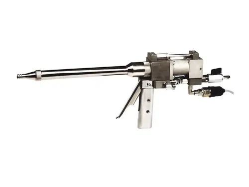

MarMax SP 30
- 2 material ports for spraying
- hand operated lever
- output: 1 up to 6 l/min

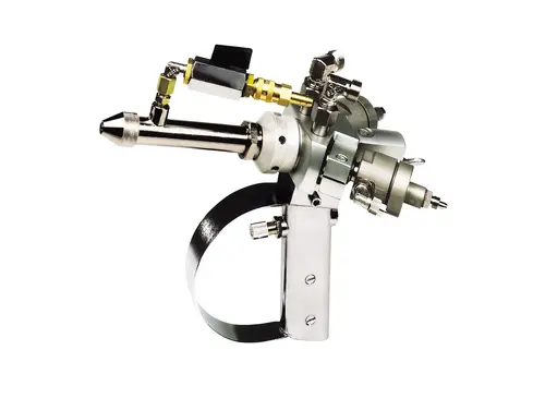

MarMax GSP 35
- 4 material ports for casting or spraying and 2 air purge/solvent flushing ports
- handle with electric push button available
- automatic flushing valves
- output: 0.5 up to 4 l/min

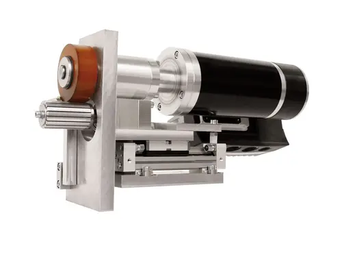

Fiber optic cutting unit
- Glass fiber yarn draw-in by electric motor drive
- knife roller pneumatically adjustable to two glass fiber cut-off lengths
- Contact pressure of the knife roller also adjustable
- quick mounting and dismounting of the suction device on the mixing head GSP 35 by means of a clamping lever
