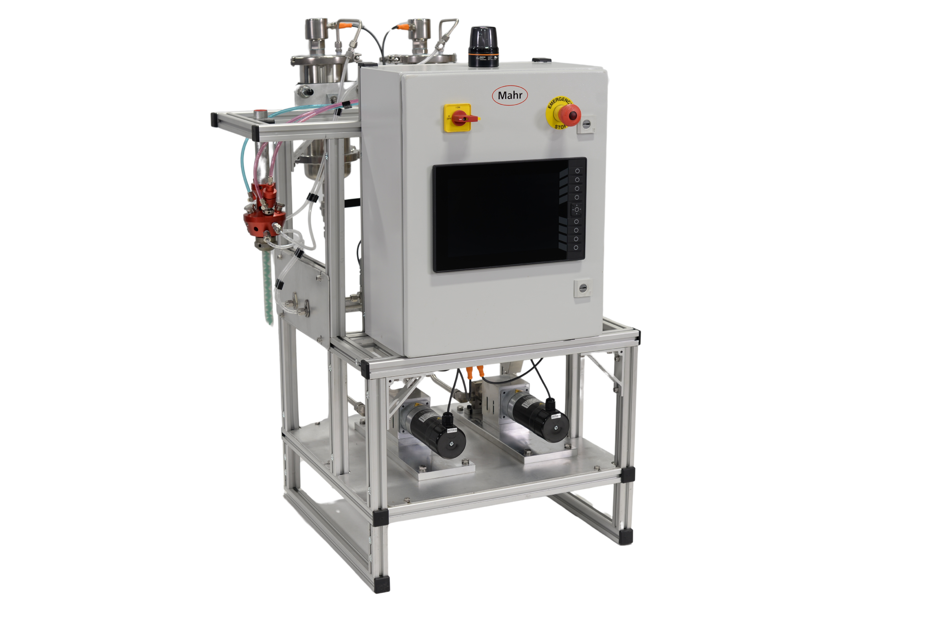

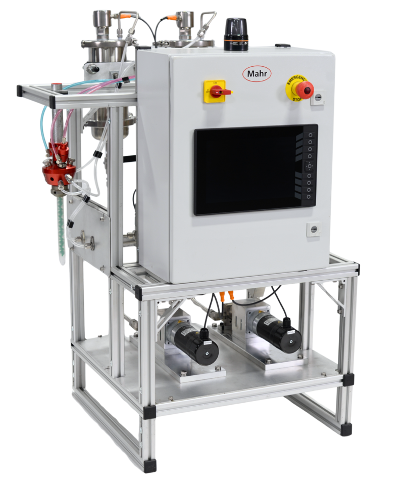

For highly accurate, low-pulsation dosing of liquids. The gear metering pumps achieve an efficient performance even at low viscosity and back pressure.
The lightweight:
2K - 3K mixing and dosing machine for small output quantities.
Leistungsstark:
MarMax LS for low flow rates
2part/3part machine for low flow rates. With an output of up to 2 gal/hr per component this model is ideal for prototyping or laboratory tests.
Lightweigt design
- flexible application
- lightweight and compact
- affordable start
- also individually configurable
While offering lower flow rates, these small machines do not take short cuts, and they maintain the industrial level components of our larger units. Designed for the North American customer in mind with UL and CSA certified designs available. Other similarities with our larger machines include customizable HMI interface to optimize operation for your individual task and ensure your success.
Flow rate | Up to 2 gal/hr per component |
Mixing ratio | Infinitely variable |
Material tank sizes | 0.33, 0.5, 0.75 and 1 gal |
Conveying element | Gear metering pump with stuffing box |
Remote servicing | Remote service capability integrated |
Tank filling | Manual |
Operation via colour touch screen panel | Screen size 10" |
- Cart also available with hose holder and mixing head holder
- Gear flow meter / screw flow meter / coriolis flow meter / flow meter virtual
- Heated tank and major components
- Gear Metering Pump with magnetic coupling
- Alternative pump designs to suit unique applications
- Flushing medium tank and/or pump
- Shot counter
- HMI customized to your process requirements

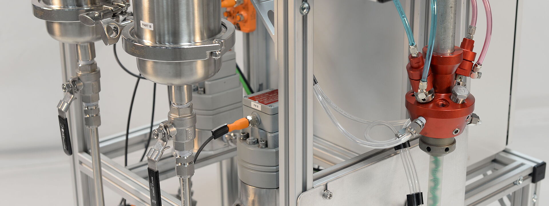

Mixing Heads – the mixture makes the difference
A perfectly customized mixing head guarantees the best mixing quality and exact discharge capacity. In order to select the suitable mixing head, we analyse the production process considering the operating parameters, such as material characteristics, the emission and the mixing ratio.
