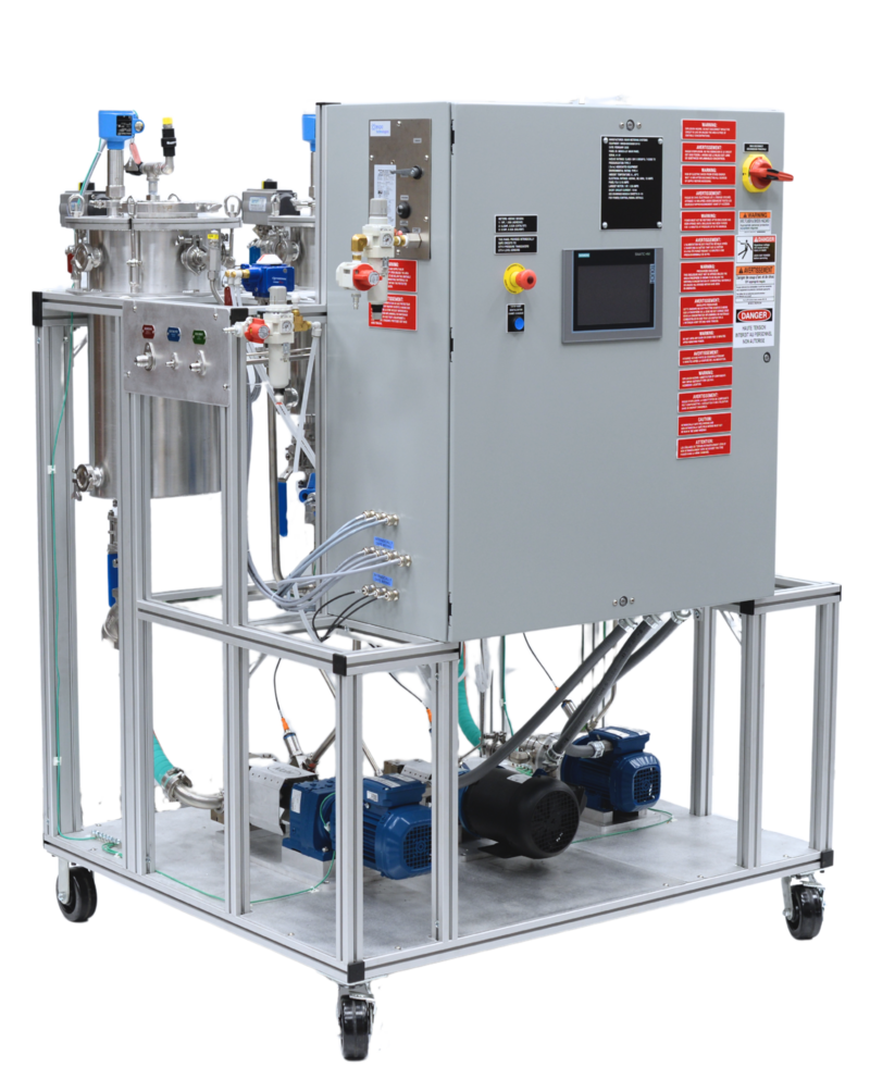

MarMax Hazloc for classified environments
2part/multi part meter mix dispense machines which are designed for high material flow rates and a max. material output of up to 10 gal/min.
Different tank sizes are available to suit.
Safety focused
- Remove mount panels
- Purged panels (z-purge or x-purge)
- Division 1 or division 2 systems
- Zone area classification
The MarMax Hazloc is a production machine customized to meet your specific needs and application requirements that operate within a classified area. Designed, built and programed in the USA by a team that is available to give you the support you need. UL and CSA certified designs available. Customizable to meet the specific requirements for the area classification of your hazardous location (Div 1, Div 2, or Zone classes).
Flow rate | Up to 10 gal/min |
Mixing ratio | Infinitely variable |
Material tank sizes | 5, 10, 20, 30, 40, 60 and 80 gal (larger sizes to suit) |
Conveying element | Gear metering pump |
Remote servicing | Remote service capability integrated |
Tank filling | Manual |
Control system | IFM with IO-Link, Siemens or Allen-Bradley |
Operation via colour touch screen panel | 7, 10, 12 or 15" depending on system complexity |
Heating | Unheated (optional heating) |
Mixing Head | Suited to product and process |
- Gear flow meter / screw flow meter / coriolis flow meter
- Gear metering pump with magnetic coupling
- Alternative pump designs to suit unique applications
- Pressure monitoring on suction side
- Flushing medium container (5 or 10 gal)
- Shot counter
- Vacuum system
- Automatic refill control and equipment
- Heating for metering pump
- Recirculation - short or long

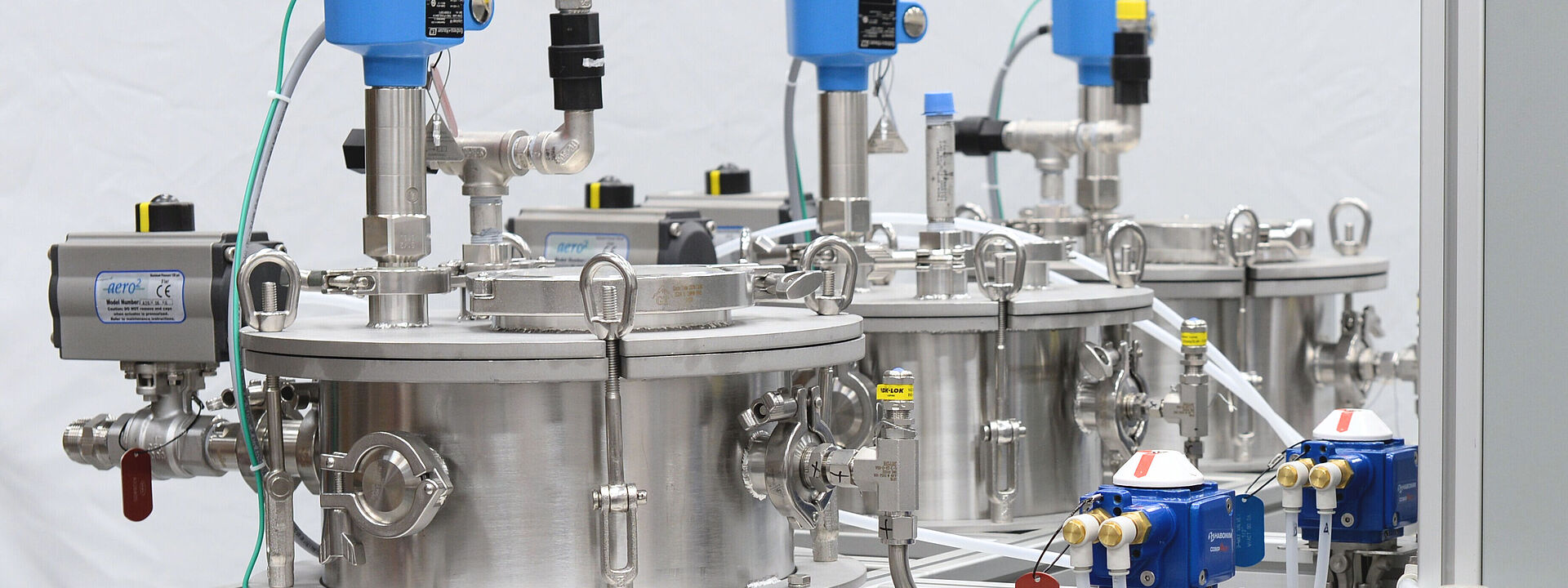

Mixing Heads – the mixture makes the difference
A perfectly customized mixing head guarantees the best mixing quality and exact discharge capacity. In order to select the suitable mixing head, we analyse the production process considering the operating parameters, such as material characteristics, the emission and the mixing ratio.
