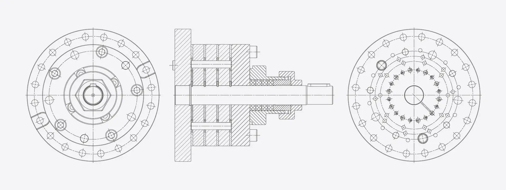

Planetary spinning pumps – representing the heart of a spinning plant. They are used in large quantities. Tight production tolerances of the pumps, reliability and long lifetime are the key words for a high-quality yarn and customer satisfaction. Feinpruef spinning pumps of Mahr Metering Systems do guarantee to withstand toughest process conditions to finally spin and deliver a first-class quality yarn to the winder.
The special feature of planetary spinning pumps is the dosing of a material flow into up to 64 equal individual streams. These pumps are not only used for production of many different synthetic fiber and yarn, of that, for example, micro fiber textiles, tights, spandex, protective clothing and even astronautic overalls will be made. Planetary spinning pumps are also used for applications of dosing glue & adhesives and almost all kinds of fluids.
