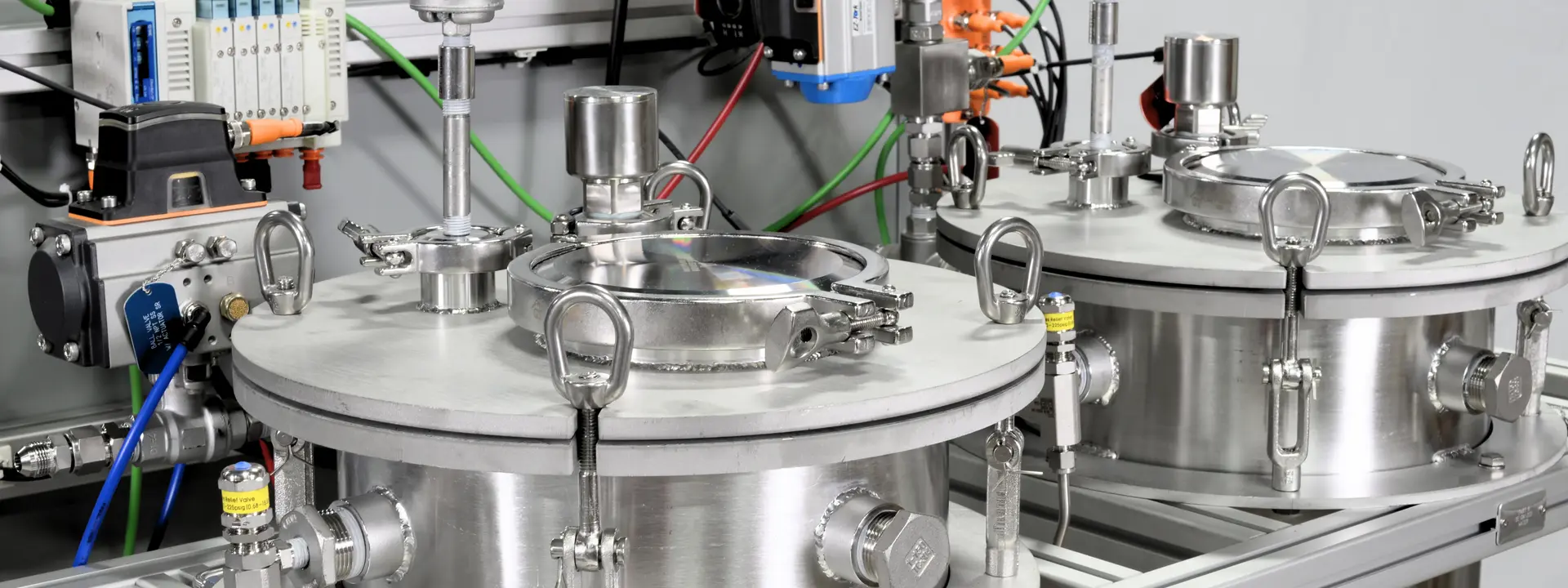

| Material tank sizes | 5, 10, 20, 30, 40, 60 and 80 gal (larger sizes to suit) |

- Gear flow meter / screw flow meter / coriolis flow meter / flow meter virtual
- Gear metering pump with magnetic coupling
- Alternative pump designs to suit unique applications
- Pressure monitoring on suction side
- Flushing medium container (5 or 10 gal)
- Shot counter
- Vacuum system
- Automatic refill control and equipment
- Heating for metering pump
- Recirculation - short or long
