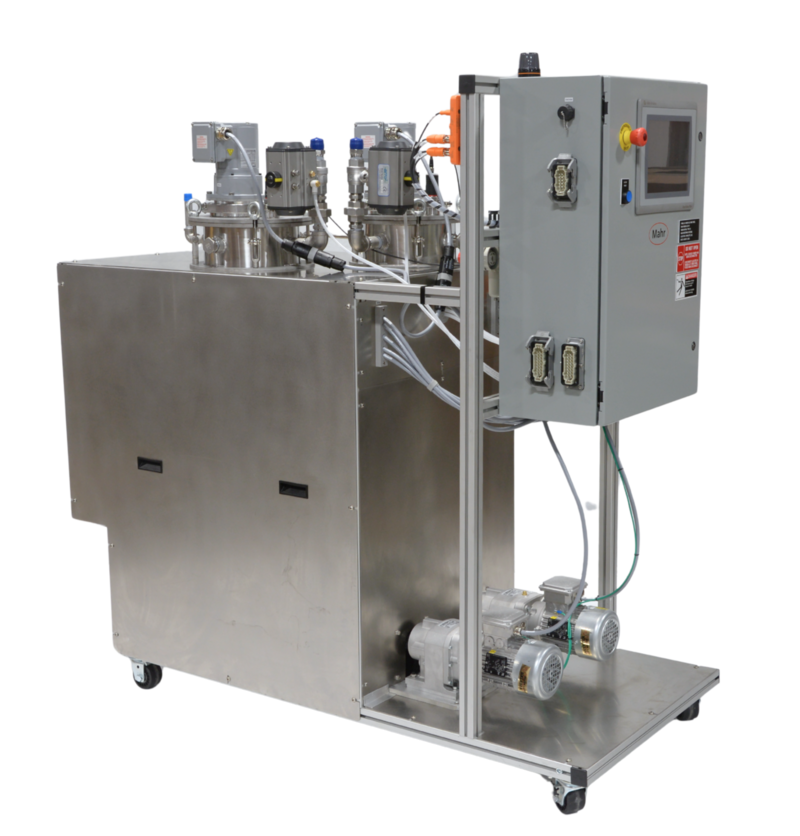

MarMax PSTC for highest degree of temperature control
2part/multi part meter mix dispense machines which are designed for high material flow rates and a max. material output of up to 10 gal/min.
Different tank sizes are available to suit.
High-capacity production
- Flexible application
- Suitable for a wide range of applications
- Individually configurable
- Automatic refill control and refill device
The MarMax PSTC is a production machine customized to meet your specific needs and application requirements and provide the highest degree of temperature control. Each temperature zone is independently controlled and housed within a heated cabinet. Designed, built and programed in the USA by a team that is available to give you the support you need. UL and CSA certified designs available.

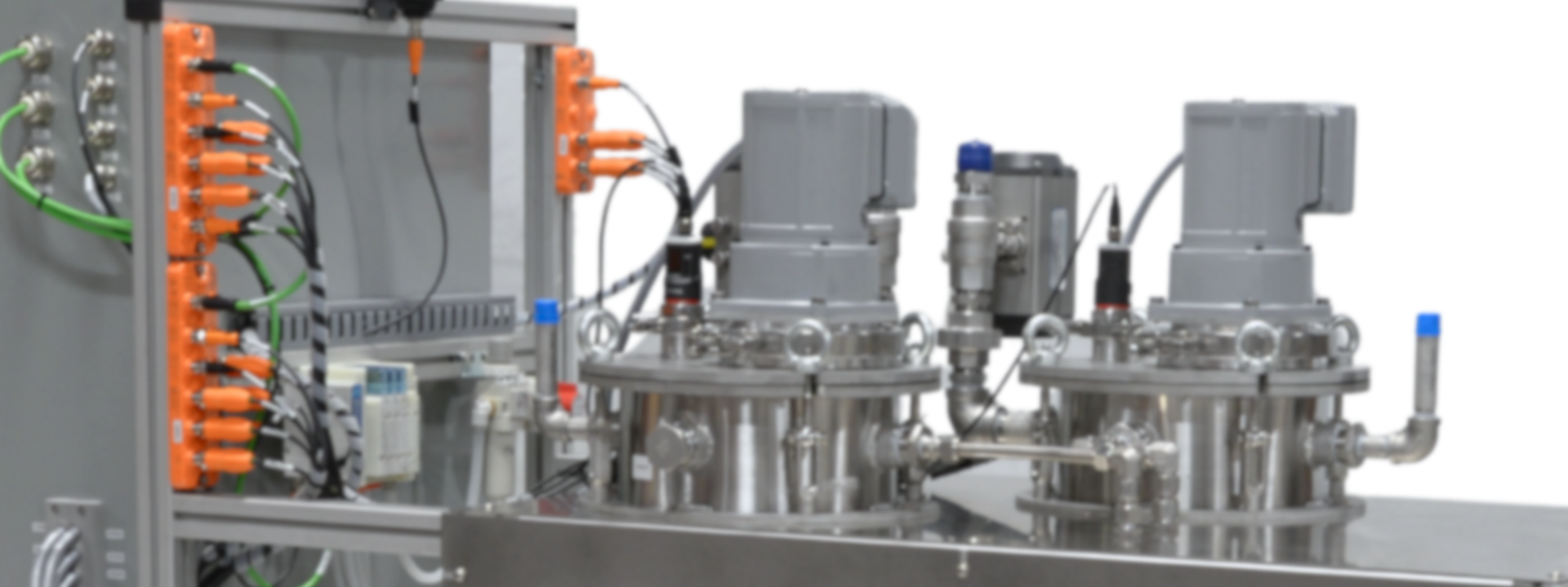

- Gear flow meter / screw flow meter / coriolis flow meter
- Gear metering pump with magnetic coupling
- Alternative pump designs to suit unique applications
- Pressure monitoring on suction side
- Flushing medium container (5 or 10 gal)
- Shot counter
- Vacuum system
- Automatic refill control and equipment
- Recirculation - short or long
