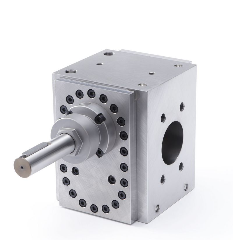

Gear pumps from Mahr Metering Systems are specially designed for the extreme demands of the chemical and process industries and offer a solution based on decades of experience in high-pressure, high-temperature, and high-viscosity applications. The design, material selection, and coating technologies have been continuously refined to ensure that the pumps deliver precise, low-pulsation flow and maximum process reliability—even with particularly difficult media and conditions.
Our solution: Mahr Chemical Pumps
Thanks to a wide range of special materials and coatings, application-specific bearing materials, and proven sealing systems, the pumps are also suitable for toxic, corrosive, or abrasive liquids. Their modular design allows them to be perfectly adapted to a wide variety of process environments.
MarChem gear pumps thus offer a reliable, precise, and economical solution for demanding chemical applications.

| Pump type per size | 5 and 10 cc/rev 20 and 50 cc/rev 120 and 200 cc/rev 350 and 500 cc/rev 750 and 1500 cc/rev | ||
| Viscosity mPas | 1 - 1,000,000 mPas | ||
| Output pressure | 120 bar standard (depending on viscosity, higher on request) | ||
| Operating temperature | up to 300 °C | ||
| Material | in correlation to the metered liquids, a variety of specialised steels, special materials and various coatings are available | ||
| Medium to be pumped | various liquids, including corrosive and abrasive media (on request) | ||
