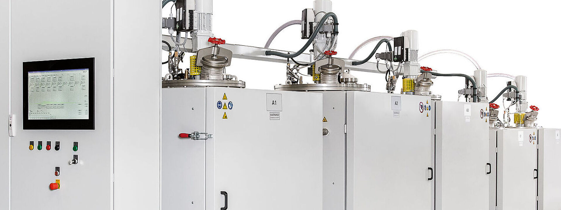

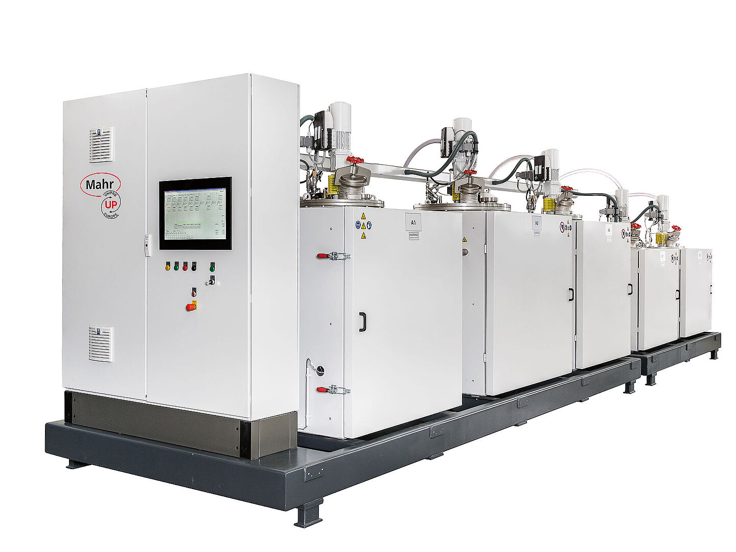

The MarMax PSTC is a production machine customized to meet your specific needs and application requirements and provide the highest degree of temperature control. Each temperature zone is independently controlled and housed within a heated cabinet. Designed, built and programed in the USA by a team that is available to give you the support you need. UL and CSA certified designs available.
