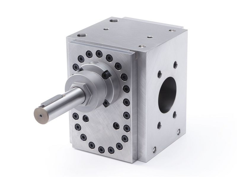

Impressive technology
- Precise feeding with minimal pulsation
- Chemical resistance, wide range of materials
- Sealless magnetic coupling or high-density mechanical seals for toxic substances
- Speed control of energy-saving motors via frequency converters to adapt to process requirements
- Certified designs for use in potentially explosive atmospheres
- Modular design for low-maintenance construction for minimal downtime
| Pump type per size | 5 and 10 cc/rev 20 and 50 cc/rev 120 and 200 cc/rev 350 and 500 cc/rev 750 and 1500 cc/rev | ||
| Viscosity | 1 - 1,000,000 mPas | ||
| Output pressure | 120 bar standard (depending on viscosity, higher on request) | ||
| Operating temperature | up to 300 °C | ||
| Material | in correlation to the metered liquids, a variety of specialised steels, special materials and various coatings are available | ||
| Medium to be pumped | various liquids, including corrosive and abrasive media (on request) | ||

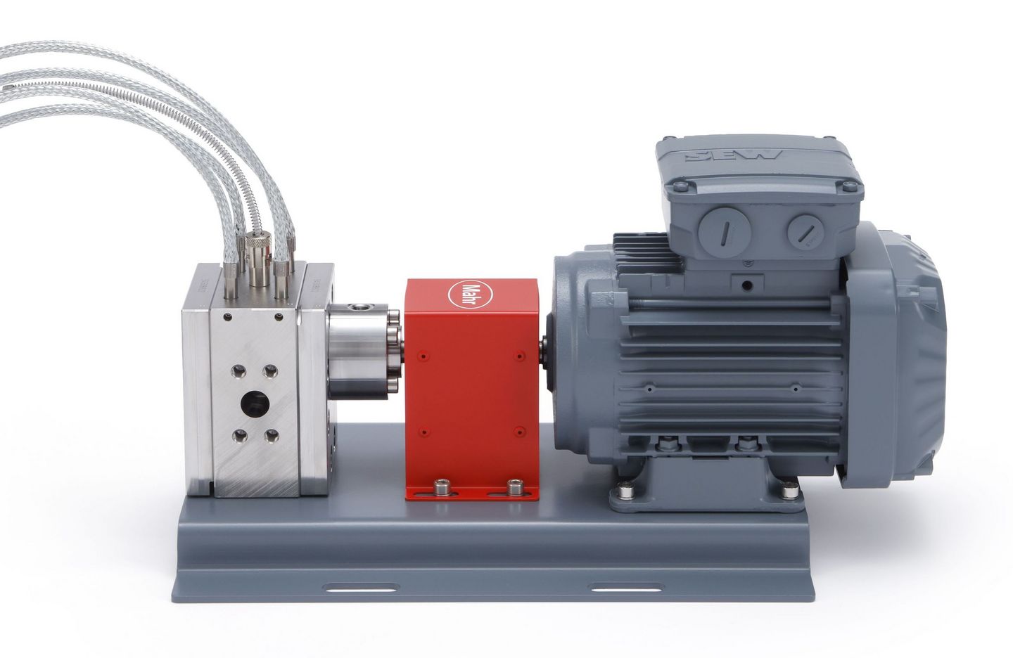

Gear metering pump with drive unit
- Base plate with mounting block
- Coupling
- curved tooth coupling
- cardan shaft
- all-steel coupling
- magnetic coupling
- Motor
- asynchronous gear motor
- servomotor / servo gear motor
- synchronous geared motor
The drive units are designed according to the operating conditions.
Sealing systems for the gear pumps
- stuffing box seal
- rotary seal
- single / double mechanical seal
- magnetic coupling
ATEX Directive 2014/34/EU
A version according to the Atex directive is available for the pump as well as for the drive.
Tempering of gear pump
Electrical heating, liquid or steam heating
Further features The dosing pumps can be supplied with additional equipment according to requirements:
- speed control by inverter
- pressure monitoring
- temperature monitoring
- flow monitoring
- communication to other machines or systems
